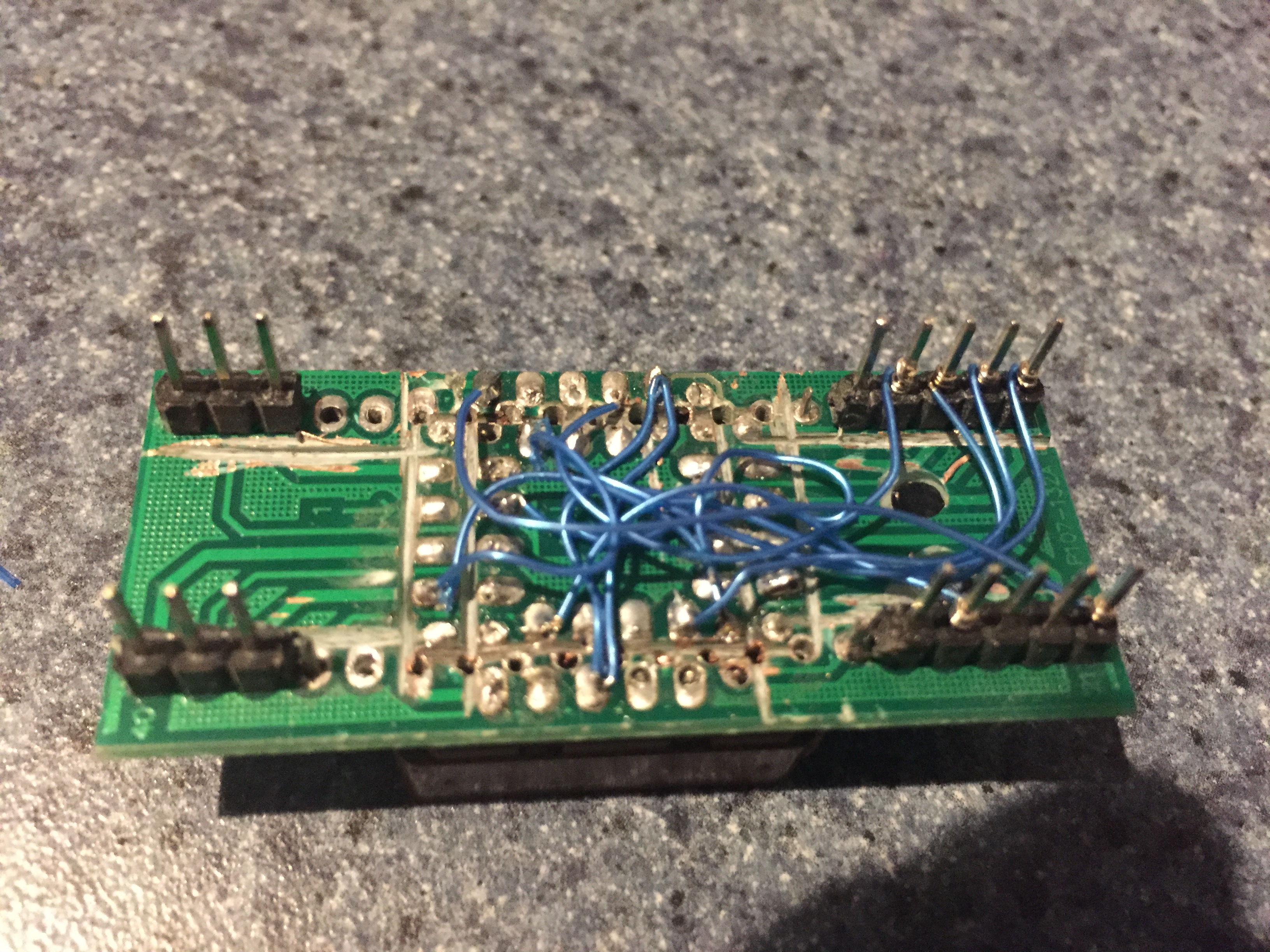

I already have 2 adapters for 44 Pin PLCC's to 40 Pin Dip... that I've aquired over the years.... Unknown origin....
I find myself having to copy an obsolete chip EPM7032AELC44-4 and make 1 or 2 spares... I have the signal name document for that obsolete chip.
I own a GQ-4x4 Programmer. Support tells me I need an ADP-097 Adapter.
I'm probably never going to need this again....
I have 2 44Pin PLCC to 40 Pin DIP adapters....
Is there anyway I could get the Schematic of the ADP-097 adapter to see if my existing adapters are compatible....... ????
OR.... Can someone post the Signal names on the GQ-4x4 40 Pin DIP Socket that exist when the EPM7032AELC44-4 is selected?
Either way, that would allow me to determine if either of my 2 existing adapters are compatible with the ADP-097

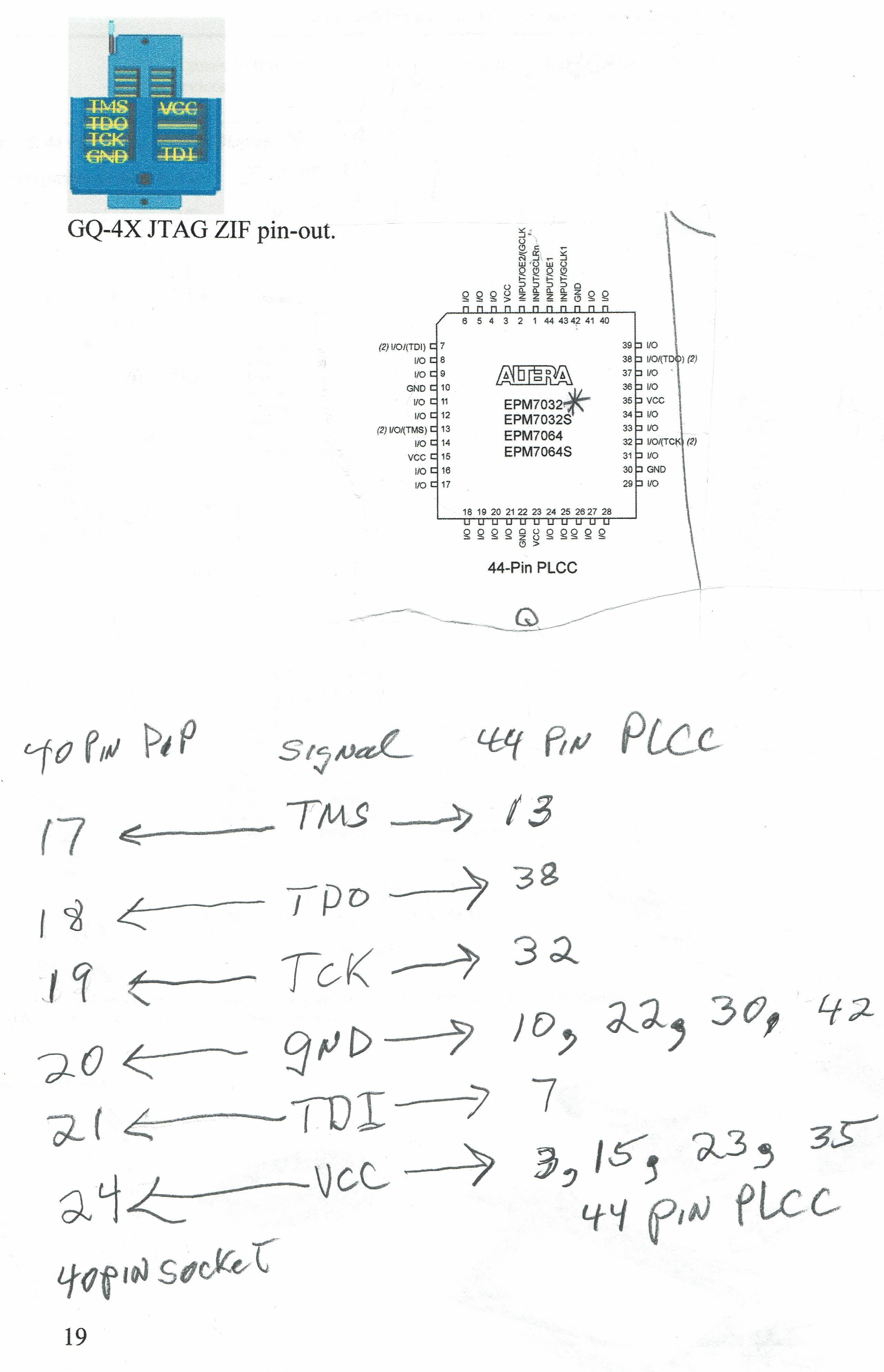

Read your manual, section 4.10.

Found Manual.... There is no pinout of ADP-097 there! There is a reference to a JTAG programmer, but Support folks Indicated the adapter I need is ADP-097 for a EPM7032 chip..
Was I steeered wrong by support or am I looking for an ADP-097 schematic to compare against the 2x adapters I already have???

Easy: https://www.mcumall.com/download/GQUSBPrgrmmerUserGuide4x4.pdf

ADP-097 is the adapter you need and you now have the ZIF pinout to compare with your adapters.

I gave you the pinout, now you can modify one of your adapters to suit your need. That shouldn't be too hard for an ex TV Maintenance Engineer. If you need further instructions for the mod, drop me a line and set aside about 5 minute of time for the actual work.

Here you go:

OK.... What you are sending, and what I asked for, based on what Support has told me is needed.... are 2 separate and different things.....
Support told me I need an ADP-097 to read/write/save a EPM-7032AELC44-4 chip.
I'm trying to see if the pinout of either of my adapters match the ADP-097 .......
And you are saying the adapter I need is the JDAT....
In off chance that I've been told something incorrect by Support....
See this picture of the ADP-097 (https://www.ebay.com/p/Adp-097-Altera-CPLD-Plcc44-to-DIP-JTAG-Adapter/1659717907 )
It doesn't match what you posted!
Is what I posted, and what Support told me on phone and in email..... Match what you posted? No.... ?????
Does the ADP-097 both Read & Write, to a 7032 chip?

I Believe I'm still looking for a schematic of the ADP-097 so as to compare it against me 2 existing Adapters...... (I seem to be repetitive)....
Here's some more history on what this is all about:
I'm trying to help someone fix a video Processor. I have same unit, with same options and same boot revision...... Just different serial number.... Mine works, his doesn't...
The MFG of this gear--has been sold 3-4 times, and the product is no longer supported for about 10 years.
$100 would buy a used operational unit, so $100 for an Adapter for an obsolete ic is not at all cost effective....
I bought the Eprom Adapter, and I've got 2 other adapters that fit the 7032 chip... I just don't know if the wiring from PLCC to DIP socket is the same.....

Is this correct for a EPM 7032 chip?
439844 bytes
Posted - 02/16/2019 :  05:02:16  Show Profile
439844 bytes
Looks fine.

Both adapters were for un-named proms. As was a 3rd
Being used to PALs, I was expecting to have all I/O’s
Needed.
1886054 bytes

Posted - 02/17/2019 :  05:54:43  Show Profile
Needed.
1886054 bytes
Not all I/O are needed for JTAG.
