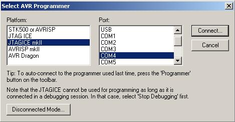

Posted - 05/14/2008 :  17:34:20  Show Profile
The blue led blinking indicate the programmer is waiting for connection.
The programmer has a build in USB to RS232 comport convertor. So, the AVR Studio will communicate it via a virtual COM port. Not the USB port.
Please check if you upgraded firmware as following procedure:
To upgrade JTAG MKII from AVR Studio 4, you have to copy the jtagicemkii.dat from
the CD directory: "update_Firmware/" to "C:\Program Files\Atmel\AVR Tools\JTAGICEmkII". Then select JTAGICE MKII Upgrade from the Tool menu in the AVR IDE.
Also,the AVR Studio only scan the comport COM1 to COM4 good. If your virtual comport is not in this range. You may want to change the comport number to COM1 to COM4 range. To change the comport number, you may need to release other comport first and then use computer device manager from the control panel, then click the device list item property
to change it.
After upgrade, disconnect and reconnect the programmer again.
Try AVRISP programming mode first:
In Select AVR Programmer window, select JTAG ICE MKII and the comport number you have, then connect.
See attached picture.
