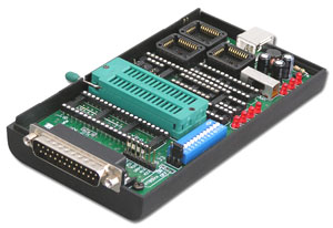

I have this version of the programmer:
http://www.ezoflash.com/willem/67.jpg
And I'm running software version 0,97ja.
When I do a blank check on 27C1000, I get the same error on all the 27C1000's I'm trying: "Device is not empty. Error at $010000"

Your sound bite makes it sound as if we didn't help you.
You were asked to see if verifying against a buffer with all 0xff would work; and it did.
You were asked to try 0.97g to see if it had the same problem. It did and my comment was "Then we live with the problem...". This is because the people with the latest source are not updating for Willem/PCB3/EZoflash and compatibles. Only PCB4.5 variants are getting updates and my efforts at contacting Sivava to collaborate on enhancements have been fruitless...
