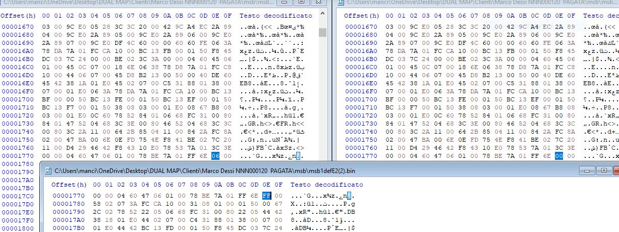

hi, today the adp 054 adapter arrived and i start to play with the 27c1024, I had a memory to read and I put it in to see if everything worked well. I read the memory 3 times and had 3 different files, there are 2 wrong bytes in the address 1770. What should I check to get the file right?
202741 bytes

another 27c1024 read with willem and still problem...

Does the 2 27C1024 have the problem at the same address?
blackdef
Italy
25 Posts
Posted - 04/21/2019 :  11:44:19  Show Profile  Reply with Quote
i don't think, the error it's on different address each time. there is a way to read the otp more slowly?
Posted - 04/21/2019 :  12:00:53  Show Profile  Reply with Quote
You can compare 2 or more reads and edit the bad values.
