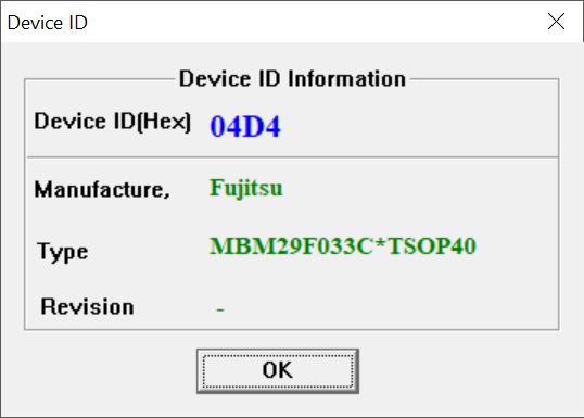

Whenever I try and verify the ID of an AMD AM29F032B, it keeps verifying as this chip:
Would this be a problem with the ADP-077 or ADP-082 adapters?
I'm also getting write errors at address 0x00000 or 0x04000.

Am29F032B is ID 0141 you simply have a fake chip.
http://www.mcumall.com/forum/topic.asp?TOPIC_ID=8418

Well, that's unfortunate.

Sometimes a few chips share the same ID but that's another story.
