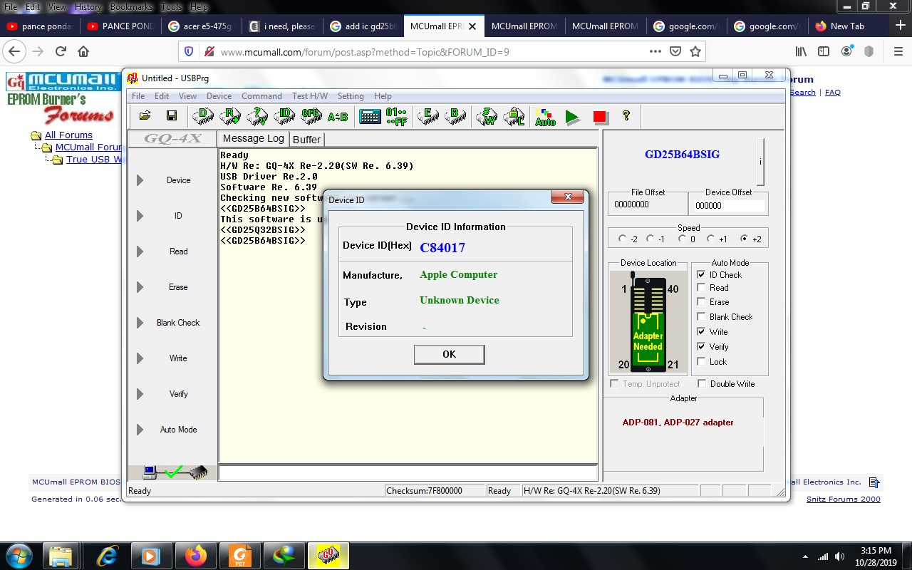

Hi, I try flash this ic with the code :
Name="GD25B64BSIG",ID="1C2017",Class="W25X10",Category="SERIAL_EPROM",MFG="GigaDevice",Vcc="3.6V",CodeSize="8388608",Adapter="ADP-081, ADP-027 adapter",Platform="GQ-4X";
but i got error code like this:
252396 bytes
What should I do,Help

Where did you get the ID from?

After I Click ID Button. Whats do you mean? Where i get this error?

You don't have the right ID. Use this definition.
Name="GD25B64",ID="C84017",Class="W25X10",Category="SERIAL_EPROM",MFG="GigaDevice",Vcc="3.6V",CodeSize="8388608",Adapter="ADP-081, ADP-027 adapter";
