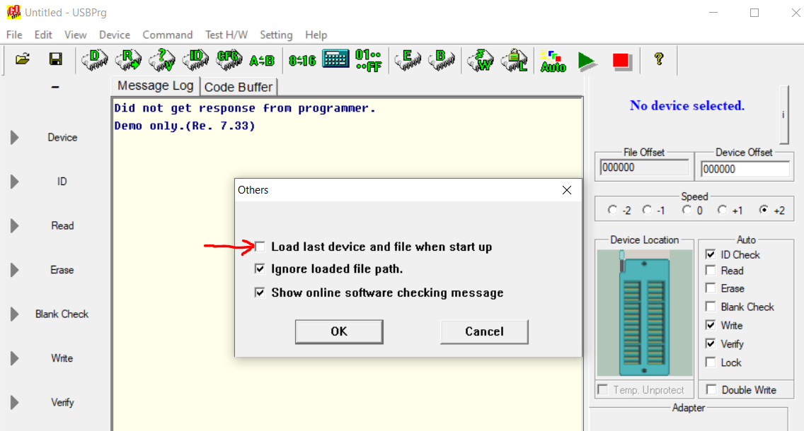

Posted - 05/28/2024 : 19:09:46
Uncheck the item : Load last device....
It is under other in the settings menu item. Picture below
