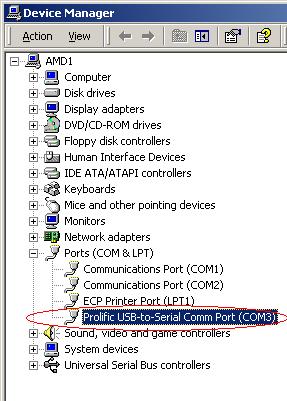

1.The USB PIC programmer uses virtual comport to communicate.
So, the very first step is to confirm the USB driver is install and loaded correctly. The USB driver is: http://www.mcumall.com/download/PL2303_XP2KME98Driver_Setup.exe
See this picture:
This picture shows the USB driver is loaded and the COM3 serial port is assigned to the programmer.
