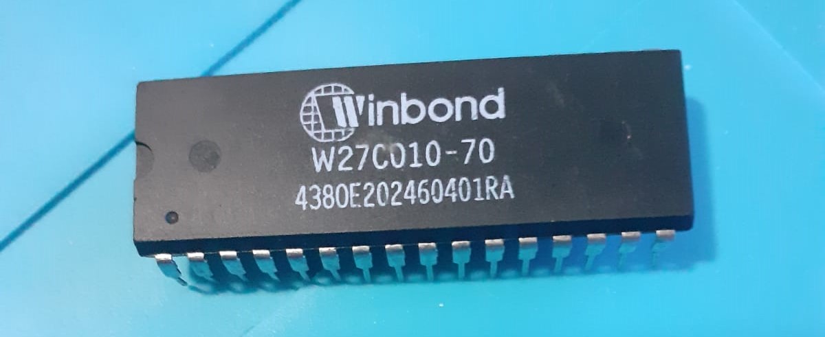

No adapter is needed. Can you post a picture of your chips?

This is a photo of the eprom.

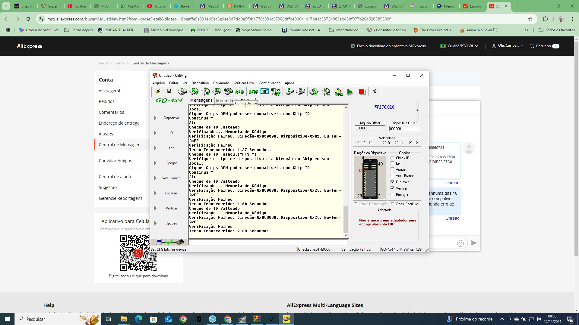

The programmer doesn't recognize it. I bought a batch of 10 pieces on AliExpress and none of the 10 worked.
The funny thing is that if you put it in a 42-pin socket and make a jumper from pin 24 of the eprom to pin 2 of the socket and put it in the programmer, it recognizes the eprom ID, but still can't verify or record it.

Looks like a blacktopped chip. You can verify this with acetone.
https://oxygenelectronics.blogspot.com/2011/01/acetone-test-for-blacktopping-explained.html
