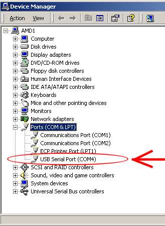

1. Confirm the USB driver is loaded correctly.
**Here is COM4 assigned to programmer. But it can be COM2-COM8

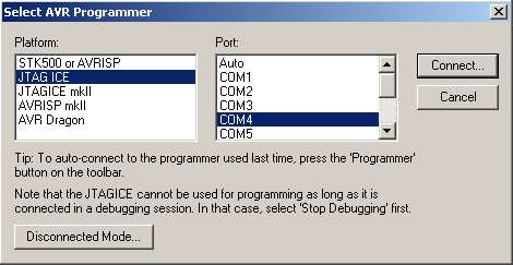

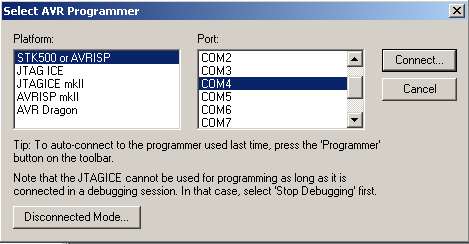

2.From the AVR Studio, select AVRISP mode connection
OR
3.From the AVR Studio, select JTAG ICE mode connection
