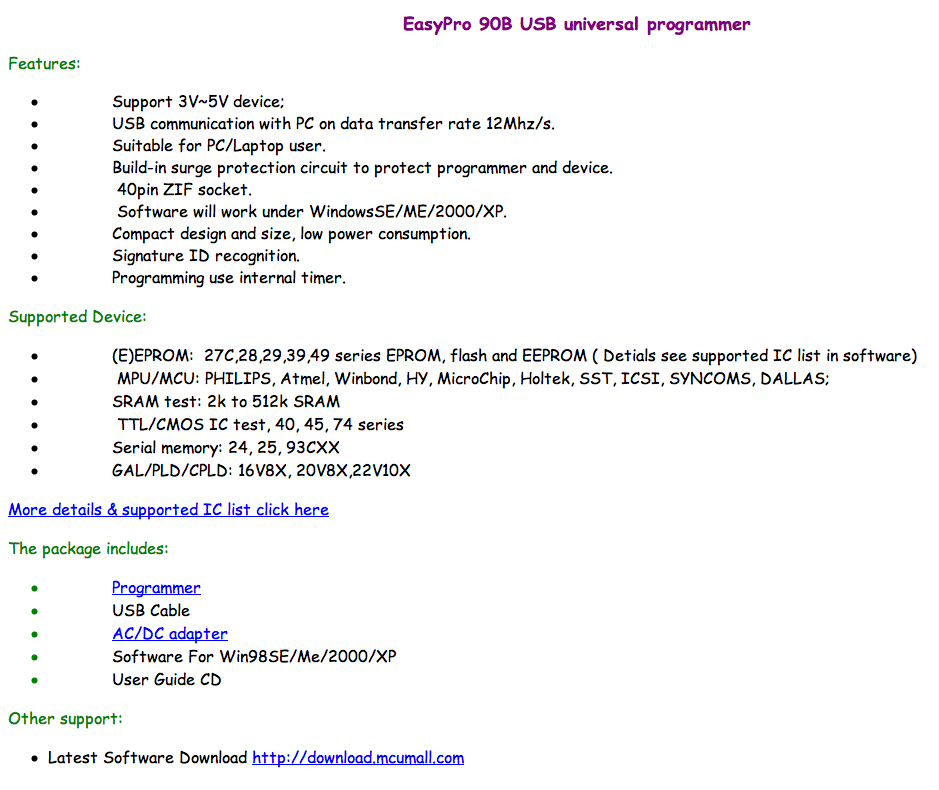

I've been trying to get an answer on this since I purchased my EasyPro 90B - I have the same issues as the original poster.
Is this or is this not supported with this programmer? The documentation provided on this website indicates it WAS supported.
See:
116.52 KB
I'd like an official answer as to whether this should work please.
Posted - 06/29/2011 : 18:42:30
This feature been removed by manufacture in newer software release. Use old version software for this feature. Like 2007 or before software releases .
