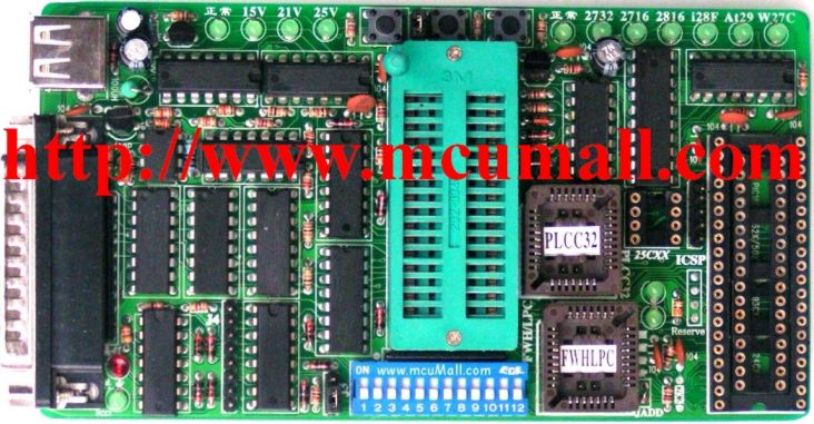

hi all new here i am trying to burn 87c257 chips but keep getting this error
error at 0x000000 chip = 0xff buffer =0x02
my programmer is a usb one which is this one
86.61 KB
any help would be greatfull accepted

Posted - 01/16/2011 : 20:24:15
Check the VPP if it has 12V.

Posted - 01/17/2011 : 13:43:06
i am getting 12.44v from vpp
