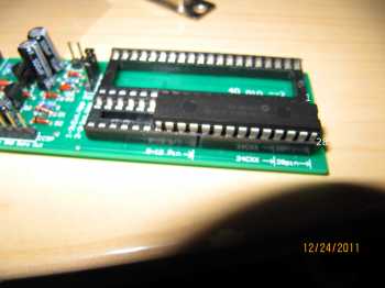

Hi i just bought a jdm programmer im trying to program a pic18f2550 microchip
do i need to set the jumper's or do anything or
will it work by putting in straight into the socket
hears a pic
19.82 KB
Edited by - OM on 12/24/2011 21:41:36

Posted - 12/27/2011 :  19:02:07  Show Profile
The green light blink when it trys to real the pic
but it doesnt detect the chip
JP2 pins 2-3 have jumpers
the ICSP has no jumper
is the pic faulty or the programmer
im trying to program Pic18f2550-I/sp
Posted - 12/29/2011 :  10:35:19  Show Profile
Looks OK.
Try followings:
1. Confrim your RS232 cable is working. and you RS232 port is not the USB-serial adapter.
2. Get another different type PIC chip and see if it works.
3. Confirm your chip is a good chip.
4. Try to program the chip via ICSP port connection. (5 wires connection)
