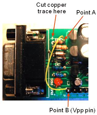

One of the user did the modification on Enhanced JDM. This modification may increase the compatibility on some chips which need the Vpp before Vcc to enter the programming mode.
Cut the trace and then short the A and B point.
