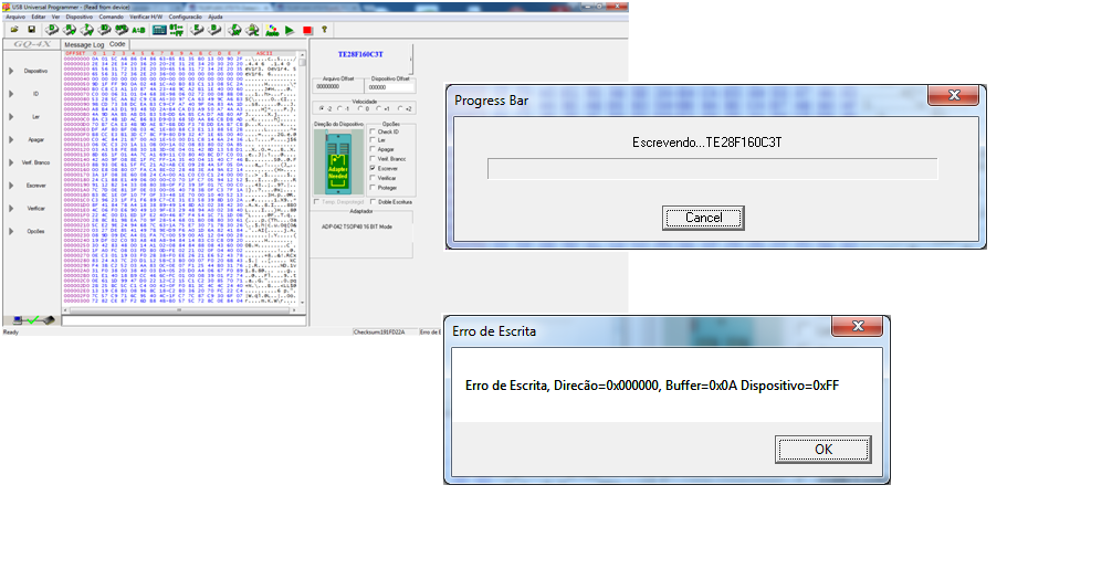

I am unable to make the recording of flash memory TE28F160C3T in the recording of a failure, with a message.

Can you ID the chip?
Make sure you can get correct ID. Otherwise check the chip pin contacting.
