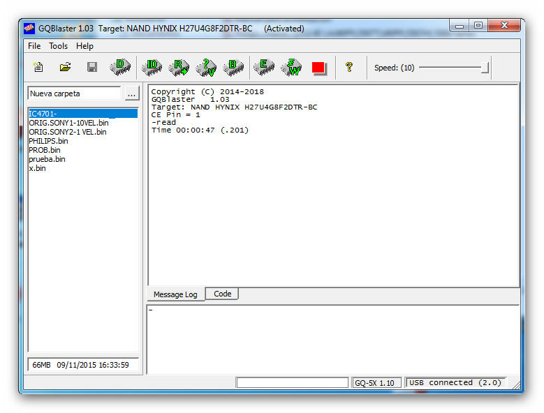

Hi, I just bought the GQ-5X and let me know if you can read and write a NAND, Hynix brand, H27U4G8F2DTR-BC model. Is a 4Gbit (512M x 8bit). In the menu of 1.03 GQBlaster this model is not listed

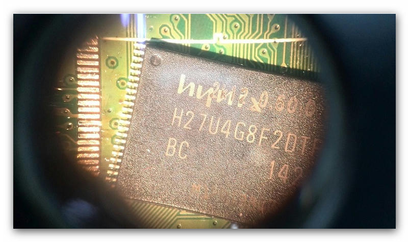

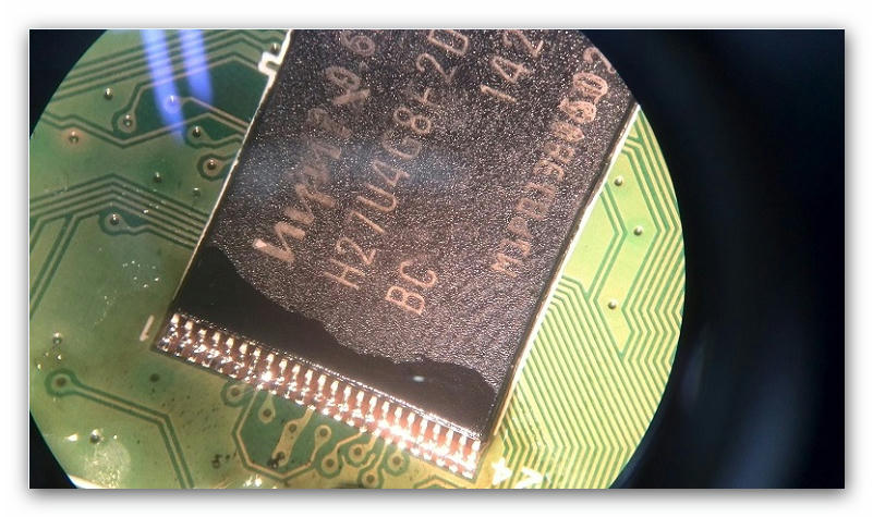

Yesterday I was welding the NAND memory and if that correctly detects the programmer, and also reads it without any problem. The trouble is that I haven,t another virgin, to test if recorded properly. As the TV works ok with that NAND,
I prefer not to risk on overwrite the same file saved.I trust that records coorecto too.

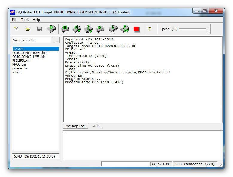

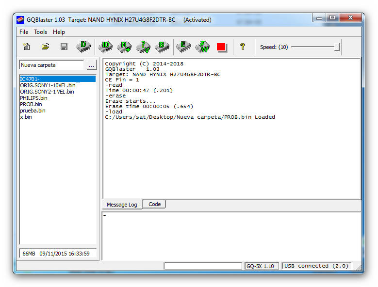

I finally decided to record it with the dump read of it, and as I expected everything went perfect. TV NAND flash works OK. I've tried other NANDs, other chassis before, and even now performs well. Thanks again.
