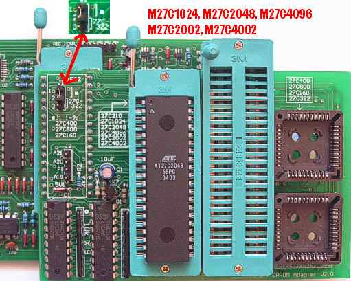

Posted - 03/27/2016 : 15:58:48
http://www.mcumall.com/forum/uploaded/zlm/201251512716_M27C1024_2048_4096.jpg

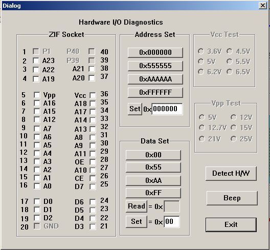

Posted - 03/28/2016 : 22:16:25
Looks like the address A9 has problem.
Check A9 pin voltage while reading the chip at slowest speed. The A9 pin should have voltage changing while reading.
The A9 pin you can find from software menu Test H/W-> Test H/W pinout:
