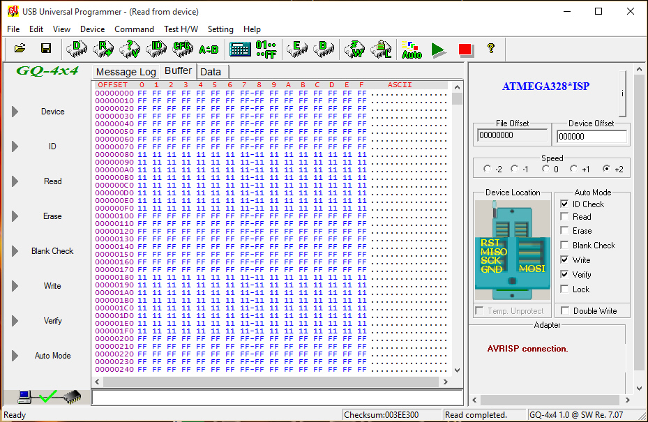

Attached is an image file of what I get when I write all 11 to the chip and read it back. The eprom section of the chip works fine and the written data reads back with the same checksum.
The Flash part of the chip reads back as shown in the attached file.

Posted - 04/11/2016 :  20:34:10  Show Profile  Reply with Quote
It seems a software bug on this chip.
