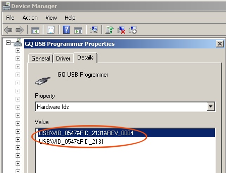

My GQ-4X programmer stopped working, it doesn't accept ANY of the drivers. In device manager its always a unknown device.

Right click on the unknown device->properties->Hardwar ID
You should see this:
GQ-4X Hardware ID from device manager:
48109 bytes
If this is OK, then install this driver:
http://www.mcumall.com/downloads/download.asp?DownloadID=55

my ID is almost the same except its a 3 at the end and not a 4. I tried installing that driver but my computer doesn't seem to able to detect it.
gamemaster76
Posted - 10/24/2016 :  08:26:06  Show Profile  Reply with Quote
It installed after I moved the drivers to a new folder. Thank you very much! :)
