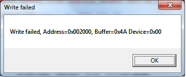

I only tend to program ST M27C1000 EPROMs. All was working up until last week, but now, every time I try to program, it fails at 6%.
The EPROMs themselves are ok (I've blanked them, and programmed with a different programmer).
I can verify and blank check OK, but not programme.
Any ideas or suggestions?

what is your exact error message?
If there is no contacting problem involved, then the problem may come from the programmer hardware.
roybridge
Posted - 11/27/2016 : 12:01:43
This is the exact same error I get with each M27C1000 device that I try to write with my GQ-4X.
The devices are OK as I can program them with my TL866A programmer.
18280 bytes
Posted - 12/03/2016 : 21:58:54
The programmer A13 pin damaged.
