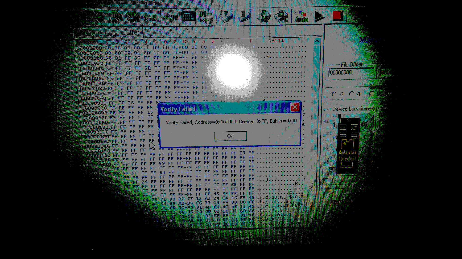

Posted - 01/22/2017 :  09:58:58  Show Profile  Reply with Quote
hello this is the problem iam now getting was fine , but now it will not read or right,,, iam thinking its the programmer, I have bought new 004 and 088 adapters again,
1080078 bytes

by the way this is a new chip , iam trying to write too

Be sure you are using the right pin-out / adapter.
Even so I find I also cannot write some brand new V6 chips I have.
I suspect either the programmer is not using enough voltage, or, there is a chip issue (i.e. counterfeits / out of spec / mis-formatted from factory). I've been told to use either a different programmer, like an R270, or one of those "M35080 dedicated" programmers to erase them again, which seems like a terrible waste of $$$ since you'd think a generic programmer should be able to do it given the right instructions. Maybe the MCUMall programmer isn't providing high enough voltage...?
