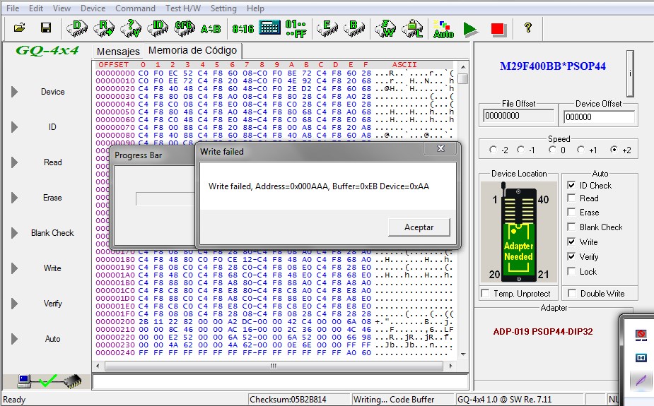

Hello guys, i have an GQ-4x4 1.0 , Soft 7.11
I can read an M29f400FB with ADP-019 v4.1, but cant erase or re write.
checked pins , usb cable checked.
Check ID say :
Device id (hex) C0EC
Manufacture not in library
type unknown device
revision -
But anyway let me read it
Any idea? :/

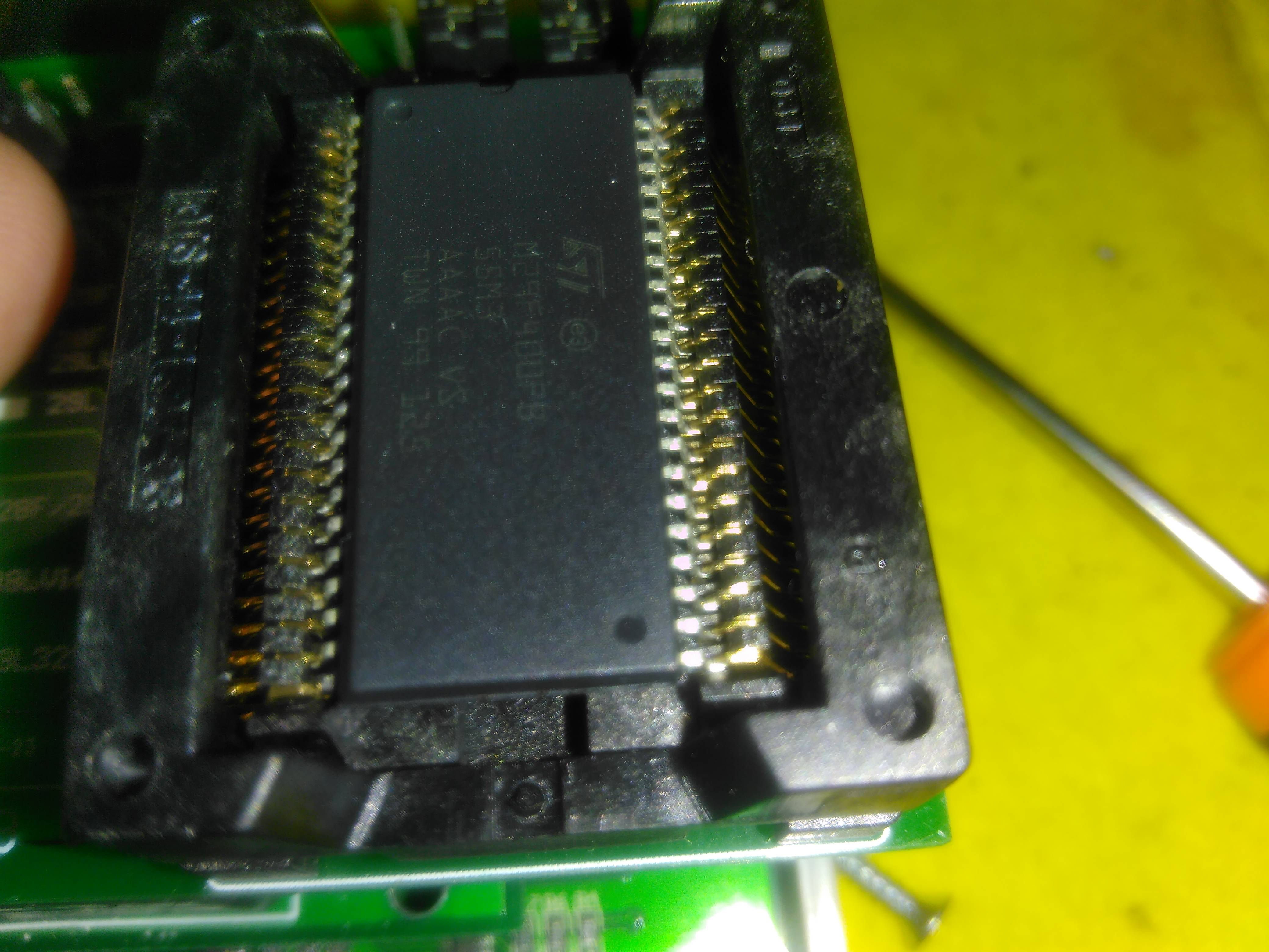

This is from an ECU EMS3134 what i need immo off
Is an ST chip , but only i can find this datasheet about it xxxxxxFB

Your datasheet gives the same ID as a Micron. Could the ST be a mask?

I buyed another ST 29f400 "BB" and i can read , erase and write.
Maybe old eeprom was failed
Thank you very much for your interest for helping
Kind regards
Posted - 05/20/2017 :  19:15:08  Show Profile  Reply with Quote
Maybe or it is a mask version.
supervizeur
462 Posts
Posted - 05/29/2017 :  06:22:37  Show Profile  Reply with Quote
Mask ROM are common in ECU.
