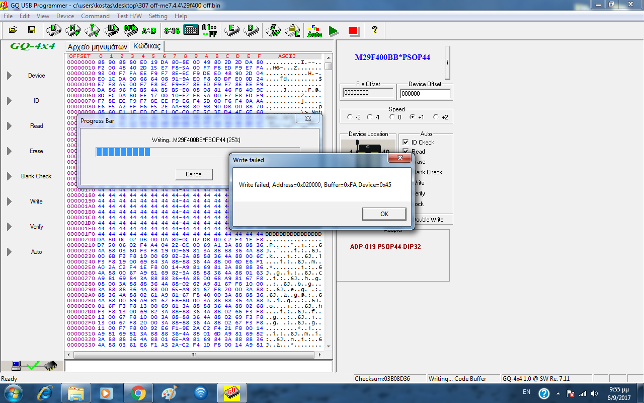

Hi,
It is the first time that I try to write Flash eprom M29f400BB with psop44 but I receive message ''write address failed 0x002000''
The steps that I do is :
1. I choose the flash thatI will work
2. I put the eprom in adapter psop44
3. I read the eprom
4. I erase the eprom
5. I do blank check
everthing is ok
6.I try to write eprom and I receive the message above.
I have try to remove the adapter psop44 and epro 29f400 and put it again to the programmer but the problem still remain.
Could someone help me to solve this propblem

Hi,
The problem solved after clean the pins of eprom.

Originally posted by gusdaver
Hi,
+1 Many times oxydation is a problem.
