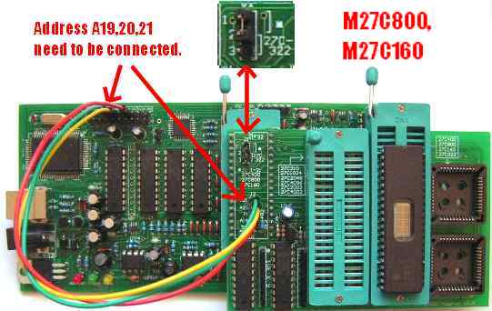

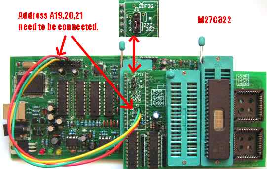

I saw these pics in the sticky section above to read and write M27V322 and M27V160 ICs.
Do I really have to remove the main board and run wires to the adaptor board? I can, I'm an electronics tech but really?
Could explain why they don't work.

Yes A19 A20 and A20 need to be connected for the correct addressing scheme to function on this adapter.
