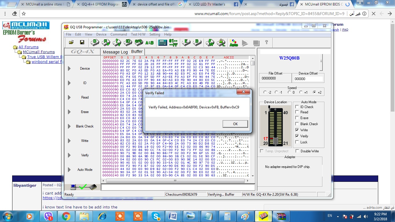

Posted - 03/02/2018 :  11:24:08  Show Profile  Reply with Quote
hi
i read it but the verify failed is it file - device offset issues? i just load bin and clicked on write verify
Download Attachment:
409360 bytes
hi
Posted - 03/05/2018 :  19:30:19  Show Profile  Reply with Quote
do blank check before write. Also, try slower speed.
