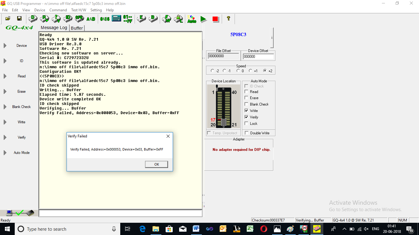

Hi,
i recently purchased an GQ-4x4 updated the software and usb drivers. i am able to read the 5P08C3 eeprom data. but unable to write.i get the below mention error.
Device write complete ok
ID check Skipped
verifying... Buffer
Verfify Failed, Address = 0x00053, device = 0x03, Buffer = 0xff
I have attached the screen shoot of the same
waiting for your reply
Regards
Dayananda.T

Hi this works fine on my GQ-4X old ,
if I was you I would unscrew the programmer and test all pins on the zif socket to the pcb connectors with a multi meter, as I have found one pin not connected but the solder looked good,
Dave

No need to open up the programmer to test it, you can simply use the software...
