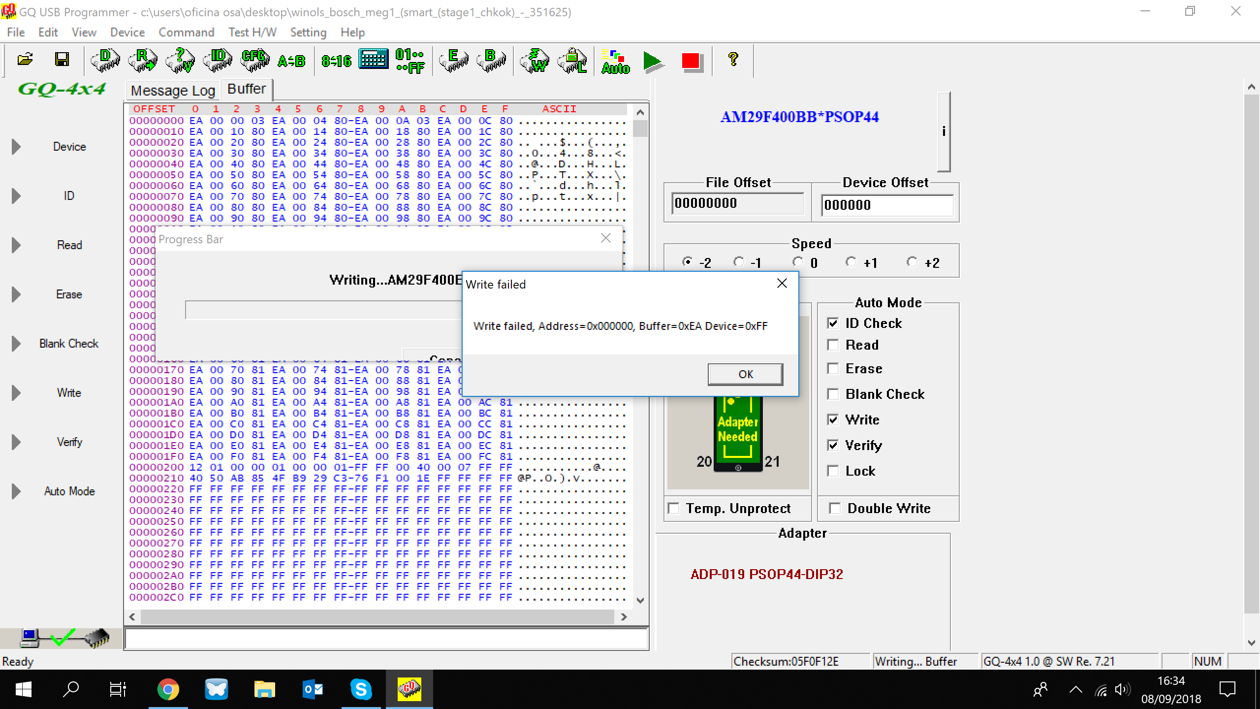

Im facing some problems when writing a AMD 29F400BB
Already change the speed, put on 5v, connect external power, etc.
270513 bytes
Anyone could help please?

if you can get ID correctly, then you may need to check if the chip has been protected.
Click on L button to open the chip protection Window.
