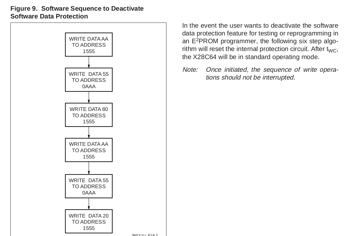

I have the GQ_4x4 and am working with 28C64 8Kx8 EEPROMS.
I can program a new Altera chip no problem; but I need to sort out a pile of old used XICOR X28C64 chips that I believe have SW data protection.
96704 bytes
How can I implement this in a script to disable it and to allow me to write to the chip? My attempt at a script is below (did not work):
; remove 28HC64 data protection
device X28HC64*PLCC32
uncheckbox verify
wait 1
fill AA 1555 1555
write
fill 55 0AAA 0AAA
write
fill 80 1555 1555
write
fill AA 1555 1555
write
fill 55 0AAA 0AAA
write
fill 20 1555 1555
write
message Script End
