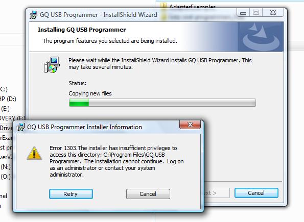

Posted - 05/26/2009 : 23:34:37 My laptop has Windows Vista 32 Bit. I tried to install GQUSBPrgRe4.01 on it but I got this error.
 45.72 KB
I installed GQUSBPrgRe3.03 but it couldn't detect CQ-4X. When I run this program it shows this error:
 9.6 KB
My laptop detects GQ-4X as "Pasco Xplorer Bootloader", but it doesn't work.
Are you sure that it works with Win Vista 32 Bit? I tried to install Software V4.01 on another laptop, but it was the same situation and the same problem. |

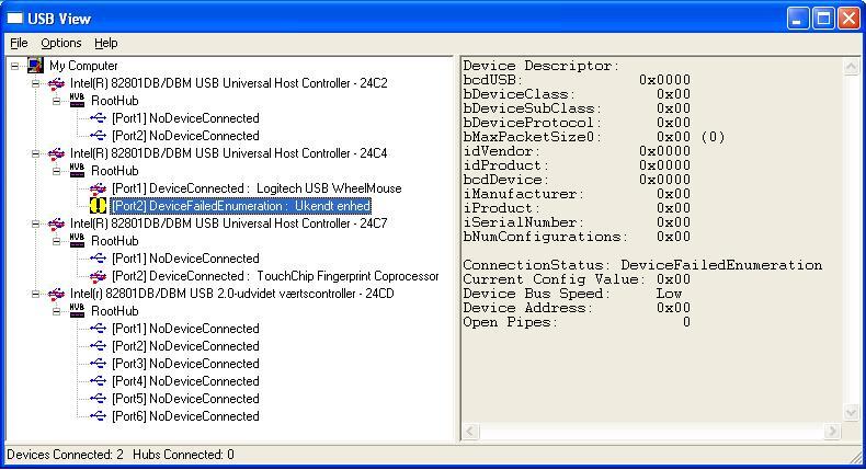

Posted - 05/07/2010 : 08:43:30 Can you try it on another computer? Did you used a USB hub?
Check the USB driver from Windows Device Manager first. see:
For unknown device in the device manager, you need to Download and install the USB driver Re2.01 for GQ-4X OR Re3.00 for GQ-4X V4(GQ-4x4) via Update the driver: see:
USB driver Re2.01 for GQ-4X OR Re3.00 for GQ-4X V4(GQ-4x4):
You should see this from software lower left:

Posted - 05/07/2010 : 07:58:20 Hi,
I just my GQ-4X programmer in the mail today, but when installing the USB driver v2 as described above my windoes does not detect the programmer....
I get the unknown USB device problem from Device manager and can not update the driver version.
I then use the application USBView and it's telling me the following.
 75.45 KB
How can i make my windows detect the GQ-4X programmer ? |

Posted - 05/27/2009 : 09:43:53 From Excalibre:
"Just need to right click on the setup file and run as admin, installs ok then."
Thanks to Excalibre.

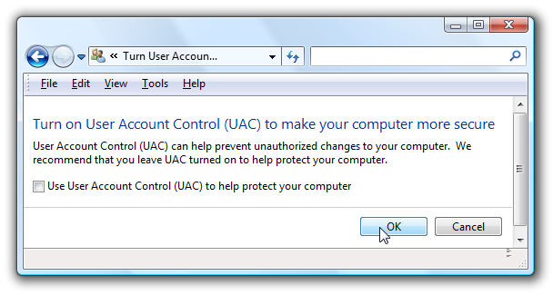

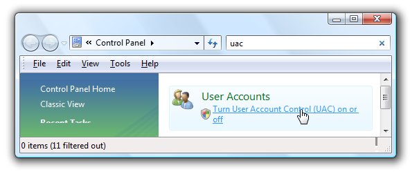

================================================================== ================================================================== For installation on the software, can you try to turn off the UAC from your vista?
steps:
1.Open up Control Panel, and type in "UAC" into the search box. You'll see a link for "Turn User Account Control (UAC) on or off":
2.On the next screen you should uncheck the box for Use User Account Control (UAC), and then click on the OK button.

Posted - 05/27/2009 : 09:04:26 The installer complains about not being run as admistrator, and is therefore refused access to that directory.
Perhaps you can fix it by logging in as administrator (prefered way) or by setting the permissions to that directory less restricted?
