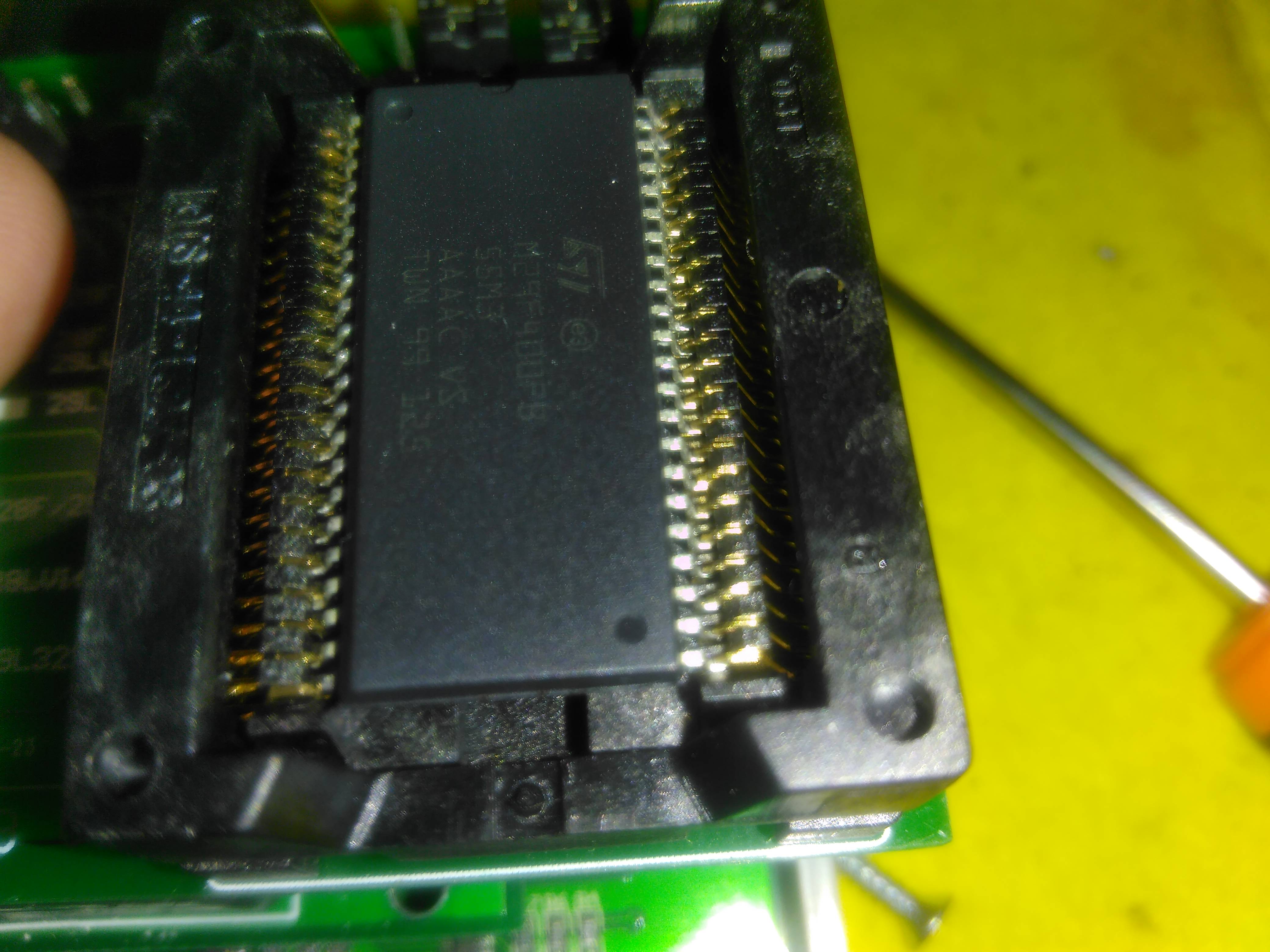

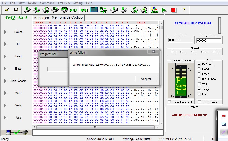

Hello guys, i have an GQ-4x4 1.0 , Soft 7.11
I can read an M29f400FB with ADP-019 v4.1, but cant erase or re write.
checked pins , usb cable checked.
Check ID say :
Device id (hex) C0EC
Manufacture not in library
type unknown device
revision -
But anyway let me read it
Any idea? :/

Posted - 05/18/2017 :  03:31:53  Show Profile  Reply with Quote
ID is no correct. The read is good or garbage?
danmarq
11 Posts
Posted - 05/18/2017 :  06:33:09  Show Profile  Reply with Quote
good aparently, and verify is ok.
This is from an ECU EMS3134 what i need immo off
Is an ST chip , but only i can find this datasheet about it xxxxxxFB

2600 Posts
Posted - 05/18/2017 :  07:40:53  Show Profile  Reply with Quote
Your datasheet gives the same ID as a Micron. Could the ST be a mask?

2600 Posts
Posted - 05/19/2017 :  04:33:04  Show Profile  Reply with Quote
When you say verify is ok, you verify against what file?
danmarq
11 Posts
Posted - 05/20/2017 :  15:25:56  Show Profile  Reply with Quote
I verify soft, contact pins and dump, it was ok
I buyed another ST 29f400 "BB" and i can read , erase and write.
Maybe old eeprom was failed
Thank you very much for your interest for helping
Kind regards
2600 Posts
Posted - 05/20/2017 :  19:15:08  Show Profile  Reply with Quote
Maybe or it is a mask version.
