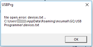

I just purchased a GQ-4x4 and try to get it to work (i need to burn a few 2532s and 2716s)
I installed the driver: by Run as Administrator this file GQUSBdriver3.0Win10.64bit.EXE
Then installed the software (Run as Admin) USBPrgSetup7.21.exe
However, starting the software gives me an error dialog stating that devices.txt can't be opened.
in fact, the entire folder that should be created in C:\Users\XXX\AppData\Roaming\mcumall\GQ USB Programmer is missing (beyond ...\Roaming\
Clicking the menu Devices>User Folder in the GUI does not bring up anything. Until i manually create
It then open a file selector window and displays an empty text file called customdevices.txt
What could be the problem? Is the software not compatible with Windows 10 v1803, perhaps?

As they say, must have something to do with security.

The default location for the software to install to is C:\Program Files(x86). This where it is installed by default on my test computer.
I am therefore assuming you decided to change it's default install location to somewhere else, hence why it not working.

Strange, I'm on Pro 1803 and never changed my default install path but it is located in C:\Users\username\AppData\Roaming\mcumall\GQ USB Programmer.
Could be a regional thing with Windows and UK users?

You are right about default location; C:\Program Files(x86)\GQ USB Programmer.
If I leave C:\Program Files(x86)\GQ USB Programmer and click "next" C:\Program Files(x86)\GQ USB Programmer gets the main program and 8 other files, the rest goes in C:\Users\username\AppData\Roaming\mcumall\GQ USB Programmer.
No, OP stated USBPrgSetup7.21.exe and I am on USBPrgSetup7.23.exe but older versions like USBPrgSetup6.38.exe and USBPrgSetup6.39.exe do put everything in C:\Program Files(x86)\GQ USB Programmer.

I noticed where i have gone wrong in my thoughts. Just looked through the site and forgot that there is two GQ-4X, the original GQ-4X and the newer GQ-4X V4, which both have different programs.
If the software for the original GQ-4X is different to that of the GQ-4X V4, it could cause problems when trying to help people because most of us are still using the older GQ-4X
I've looked through the file system on my pc and C:\Users\XXX\AppData\Roaming\mcumall\GQ USB Programmer does not exist, therefore that file location must be unique to the newer GQ-4X V4.
