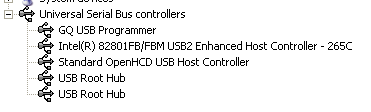

My TL866II+ works fine on my 32bit XP virtualbox SP3.
I only have USB 2.0 ports on my macbook pro, so I have enabled USB 2.0 in the VBox advanced settings and added the programmer.
When I plug it in, it asks for the GQ USB 3.0 drivers, which installed fine. XP recognizes the device as "GQ USB Programmer" under USB Devices.
However, when I run USBPrg, it says "Could not get response from programmer. Demo only."
Ideas?

I tried it on a Windows 7 Virtual machine and it seems to work there. Not sure why it's not working in XP, but I'm not really surprised considering how old XP is. It's just light weight and good for a VM.
