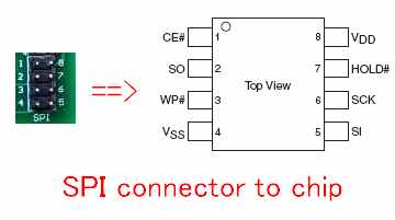

One other question. What are the pinouts of the 8 pin connector on the ADP-056 as compared to the actual chip?
Reply #20
Posted - 08/29/2008 :  14:11:22  Show Profile  Reply with Quote
[b]Adapter SPI Pin out:[/b][br][br][size=1] 8.33 KB[/size=1]

The boards have a 2x4 header for the programmer connection which is why I'm curious as to the type of connector the arrow is pointing to. Would save my some time rounding up connectors if that lead will work.
7.34 KB
Reply #24
Posted - 08/30/2008 :  10:28:11  Show Profile  Reply with Quote
if the motherboard SPI connector is female 2X4 pin socket, then you need the pin header and the jumper wires to connect:
www.mcumall.com/comersus/store/comersus_viewItem.asp?idProduct=4311
if the motherboard SPI connector is male 2X4 pin header, then you can just use the jumper wire to connect it:
http://www.mcumall.com/comersus/store/comersus_viewItem.asp?idProduct=4244
