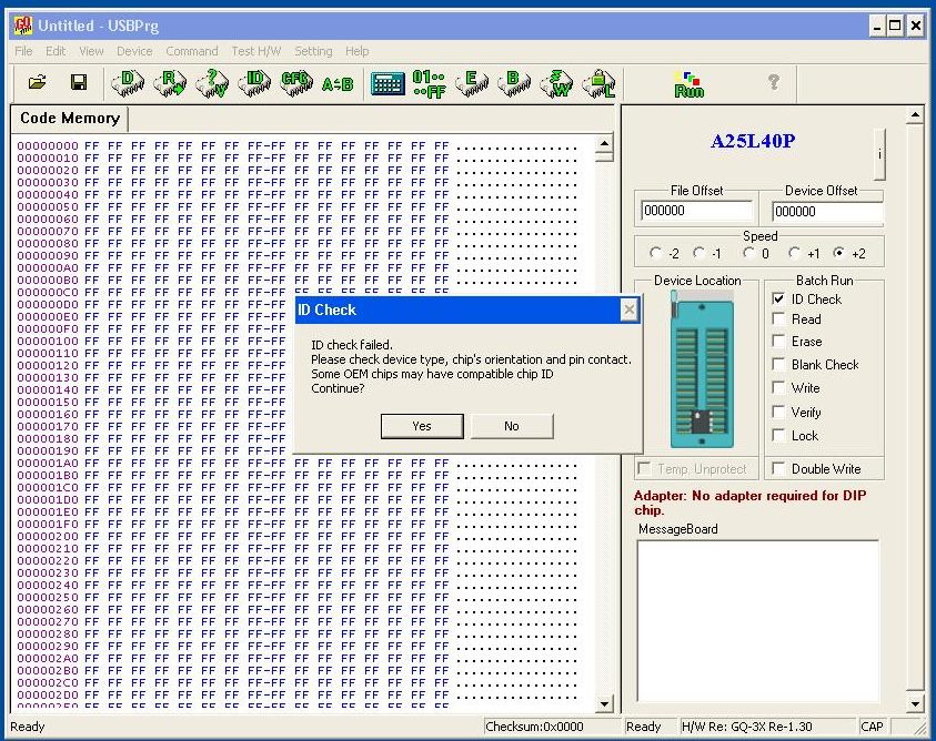

Posted - 10/19/2008 :  02:03:59  Show Profile  Reply with Quote
Good.
For now, add following lines into the devices.txt
Name="A25L40P",ID="372013",Class="W25X10",Category="SERIAL_EPROM",MFG="AMIC",Vcc="3.6V",CodeSize="524288";
I added that line to the devices.txt file but ID check failed. reads it ok but I can't ID it.
Edited by - CZAR on 10/20/2008 15:21:42

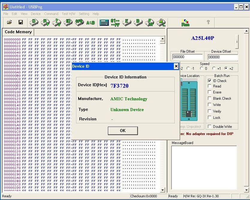

Posted - 10/22/2008 :  09:52:40  Show Profile  Reply with Quote
What is the ID you got in pop-uped ID window ?

Posted - 10/22/2008 :  15:08:26  Show Profile  Reply with Quote
Posted - 10/23/2008 :  10:54:09  Show Profile  Reply with Quote
Click on the ID button, not read/write button.

Posted - 10/25/2008 :  00:16:40  Show Profile  Reply with Quote
I guess all i got to do is change the ID to 7F3720 correct?
from this
to this
Name="A25L40P",ID="7F3720",Class="W25X10",Category="SERIAL_EPROM",MFG="AMIC",Vcc="3.6V",CodeSize="524288";
Posted - 10/25/2008 :  20:43:12  Show Profile  Reply with Quote
Yes.
You are correct.
The full chip ID should be "7F372013", but current software only read first 6 characters. This will fixed in the next software release.
But this does not affect the chip other operations.
