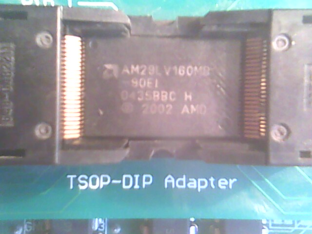

this is the chip and some others like the mx29lv160, t28f160

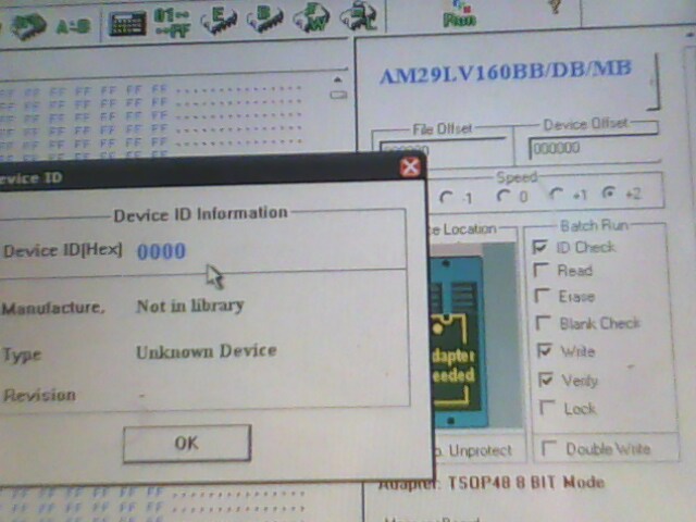

the probles is wen i select the rigth configuration the programer dont recognice the chip

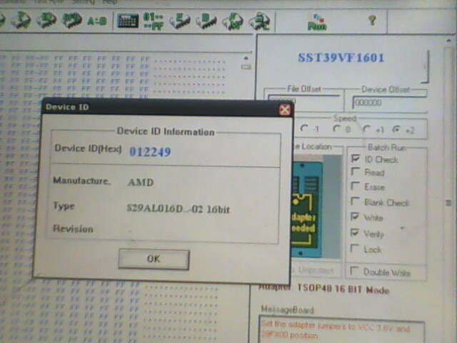

if i select another configuration then the id shows corect!!!

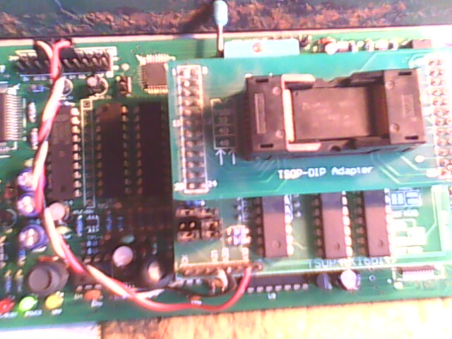

this is mi programer and configuration!!

whit the sst39vf160 configuration the chip reads ok butt cant erase or program the chip...

The adapter is not correct. The software for this chip is indicated 8 bit mode adapter. But you used 16 bit mode adapter.
