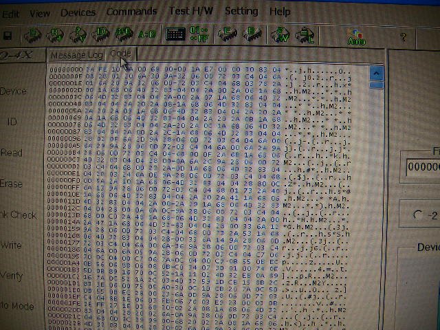

I installed programm GQ-4 in laptop Dell D600 with XP pro and get 15 group per line, same in Toshiba laptop with XP home 16 group-is correct.I can't change to 16.Could you help to change?Thank's.

can you post a screen copy?
if the image too big, the upper half will be fine.
thanks.

laptop with res 1400x1080,but I tried change to 1024x768 dont help

Hi ,ZLM.Patch not working(encountered problem).I found,that problem 15 in buffer in ver,4.01 for older laptop.Now working 16 in buffer with ver.4.00 beta5, but have same problem: message board(log)located on the middle and cover device location.

ZLM,ver,4.02beta 1 with patch ,give me 15 .Only with 4.beta5 give me 16 with message board on the middle,I posted before.

ZLM,great job.Now working excelent.16 per line.All right.Thank You.
