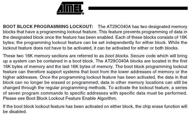

Posted - 06/07/2009 :  17:40:35  Show Profile  Reply with Quote
Your chip seems been locked out. If your chip been bott sector locked out, then there is no way to erase chip.
see:
60.03 KB

Posted - 06/07/2009 :  21:30:58  Show Profile  Reply with Quote
OK that makes sense then :-) Wil have to get another chip.
