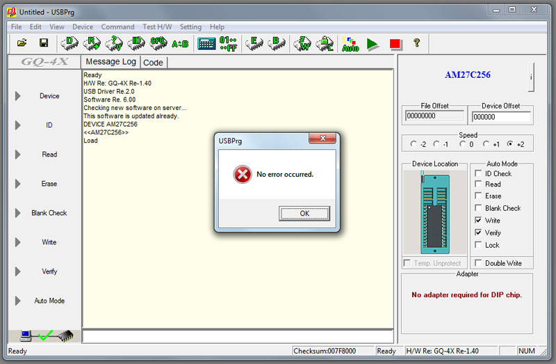

Everytime I open the software (5 and 6) I get a popup that says:
No errors Occured
How can I stop this from happening?
112.2 KB
Posted - 12/01/2010 : 12:00:46
It seems you enabled the Load Last Dvice and File When Start UP.
But you deleted the file for loading.
You can disable this load feature to identify this problem.
