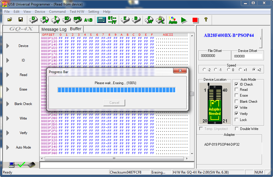

Hi!
Recently I got problem: original GQ-4X can read and verify 28f400 w/o problems, but when I try to erase the flash, it comes to 100% and the software hangs up with programmer's all 3 LEDs ON. Software update to the newest and computer change did not help.
Any ideas?
83954 bytes
Edited by - ZRimas on 10/02/2016 12:17:57
