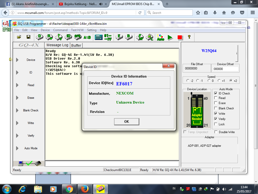

My GQ-4X can't ID winbond bios IC.

What is the part number?

Posted - 05/26/2017 :  00:15:37  Show Profile  Reply with Quote
25Q64FWSIG

Posted - 05/26/2017 :  02:32:10  Show Profile  Reply with Quote
What adapter are you using?

Posted - 05/26/2017 :  23:58:50  Show Profile  Reply with Quote
SOIC8-DIP8 adapter, but no problem detecting winbond 25Q64BVSIG

Posted - 05/27/2017 :  04:35:53  Show Profile  Reply with Quote
25Q64FWSIG is a 1.8V chip you need voltage conversion with ADP-099.
http://www.mcumall.com/comersus/store/comersus_viewItem.asp?idProduct=4630
Your device is probably damaged now.
2632 Posts
Posted - 05/27/2017 :  04:36:42  Show Profile  Reply with Quote
25Q64BVSIG is a 3V chip.
