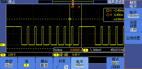

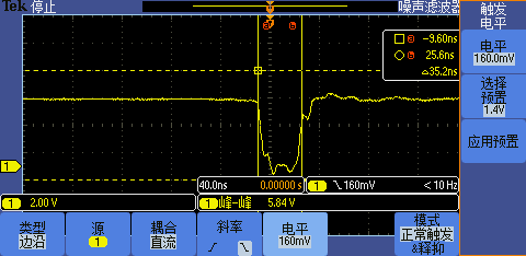

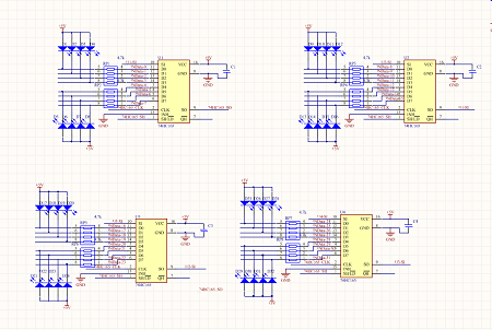

Hello~all
I would like to ask some questions about debugging SN74HC165.
The program is so easy and there are many examples in the internet. I have debuged it two days after board-making. I don’t know why it still cannot read data out and always keep 0xFF. The wave which I detect it by oscilloscope is normal. When program is ready to install into the inside register of HX165 as well as shifting out,but why the data can’t be read out?
