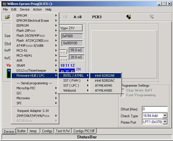

  Programming the BIOS on Willem enhanced programmer is easy, as long as we selected right chip type and right jumper. Here is an example for programming on a N82802AB of Intel845 mother board(3.3V):
Note: when programming N82802AB chip, a 12V programming voltage is needed. So, to privent chip damaged by hi-voltage, please enable the Safety Protection Jumper.
1, select chip type and software setting
 now you can see following setting:

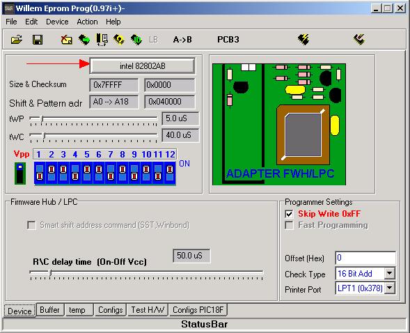

 DIP position: OFF,ON,ON,OFF,ON,ON,OFF,ON,OFF,ON,OFF,ON
  Chip's parameter is showed below the Chip  Select  Button. Normaly, those parameters are no need to adjusted, using default value.
Size&checksum:  shows chip's capacity and data buffer's checksum.
Shift&pattem adress: shows chip's address line to be used and highest address bit.
tWP/WC: shows programming  pulse width and delay time.

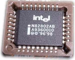

  After DIP set, check the chip's position. For BIOS chip, it should be placed in the 32 pins ZIF socket. For N82802AB chip, the program prompt user need a FWH/LPC adaptor. We only need put chip in the buld-in on board adaptor when using our Willem enhanced programmer.
Please make sure the pin one position on the FWH/LPC adaptor.
