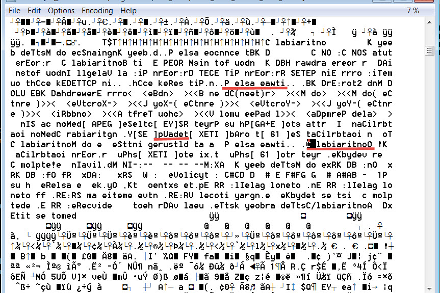

I'm trying to read content of flash memory chip. SPANISION S29JL032H70TFI and save it to a BIN file.
It looks to me that read content has swapped bytes.
Example of text to display by device where this flash is coming from. Places of each 2 following letters are swapped:
"Please wait" is writen in the BIN file as "P elsa eawti"
"Calibration OK!" is writen in the BIN file as "C labiaritnO !k:"
See details on attached BIN snapshot
I'm new to this equipment. Am I doing something wrong or is this a bug in the programmer or its software ?
I appreciate any help on this
257186 bytes

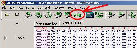

Posted - 01/29/2016 : 20:55:09
This is not a problem.
It is OK if you just want to copy a chip.
You can click on A/B button to swap the byte order.
See:
