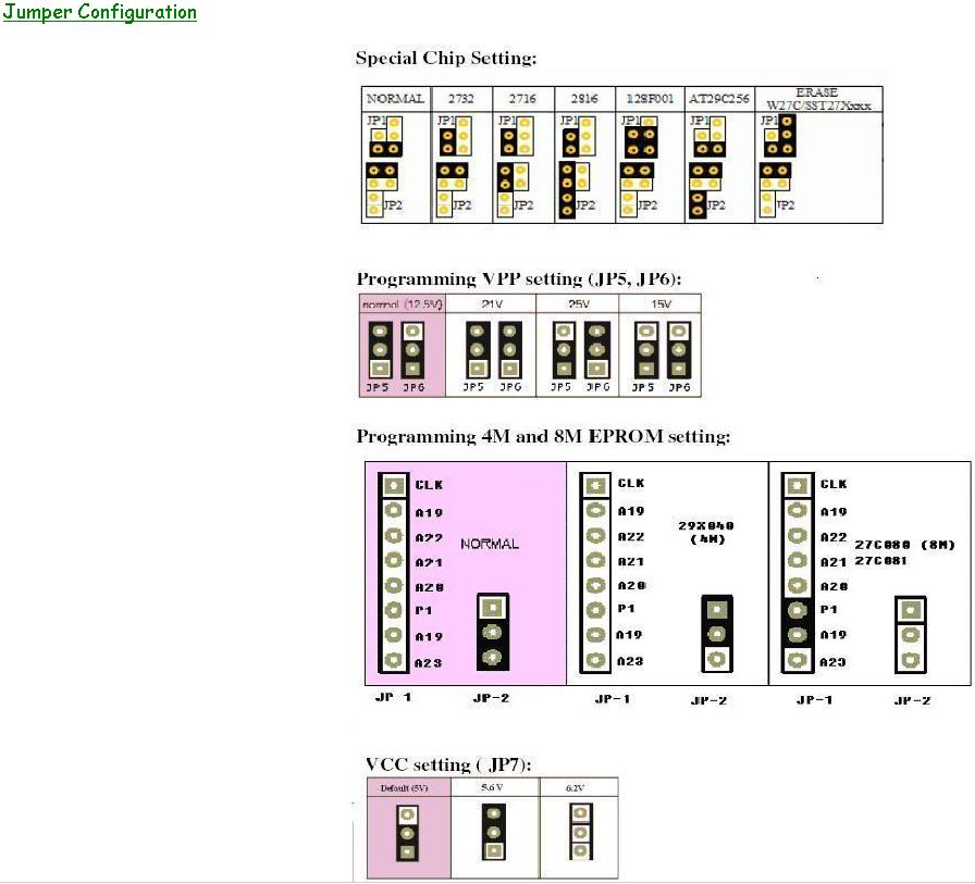

Note: For those PCB3.5/4.5/5.0C board. VPP jumper JP7 is referring to JP5 in this picture.
Posted - 03/09/2007 : 08:24:48
yes.
Chezedik
Posted - 03/08/2007 : 19:42:35
Is black where the jumper is?
