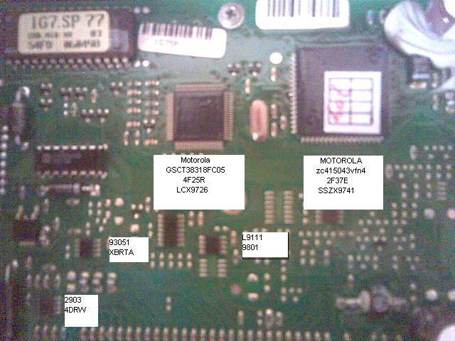

Hi fiends I have a problem with the immo of this ecu fiat that I want to remove it. someone could guide me to say which component has stored in the immo ecu this is fiat siena palio 1.6 TBI injection to gasoline model ecu 1G7.

It should be small 8 pin SOIC EEPROM chip. But I do not know which one from your picture. All those chips are not standard EEPROM chip type.

Hello this micro is hc11f1, you can read with motorola programmer in circuit to internal eprom and remove inmo very easy
