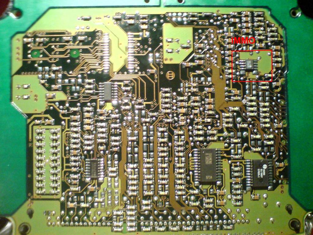

I trying to remove the immo from my afn Passat 3b. What i know ist that the data is stored over here....:
www.bilder-hochladen.net/files/7c44-2b-jpg.html
So i would like to know if i can read&write the 24c02 ic2 eprom with my willem usb. The problem is that i only have the plcc32 on my board, so i think i need an adaptor for it, dont i?
Where can i get it, especially in germany?
thnx

I think i need a SOP8 to DIP16 adapter... Where can i find it? Can i take anything i find or is it willem specific?
Posted - 09/09/2009 :  08:24:10  Show Profile
Yes. You need adaper ADP-004:
http://www.mcumall.com/comersus/store/comersus_viewItem.asp?idProduct=3103
OR
ADP-032 SOIC16 SOP16 ZIF adapter
http://www.mcumall.com/comersus/store/comersus_viewItem.asp?idProduct=3203
OR
In circuit testclip:
http://www.mcumall.com/comersus/store/comersus_viewItem.asp?idProduct=4406
the In circuit programming may need some testing and it is depending on your board design.
