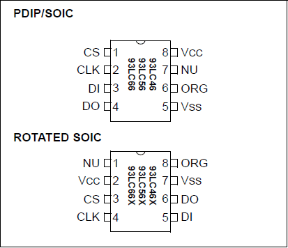

Hi,
I need some help to read this eeprom. Every time I read it, he never give me the same result.
The first time I have plug it to my gq4x, I plug it as a normal chip. But now I know is an reversed pin. Is you think I have "burned" the chip?
I want to know wich pin to plug and where. If someone can help, it will greately apreciated.
Thank you!

Allo!
I have the 93lc66A version. surface mount
11.41 KB
Is I have to switch the pin?
pin1 to pin3
pin2 to 4
ect...
For now, I'm shorting my wire.
Thank you

Posted - 09/03/2010 :  08:52:26  Show Profile
HI!
Resolved!!!!
No need to reverse pinout!
Good bin now!
