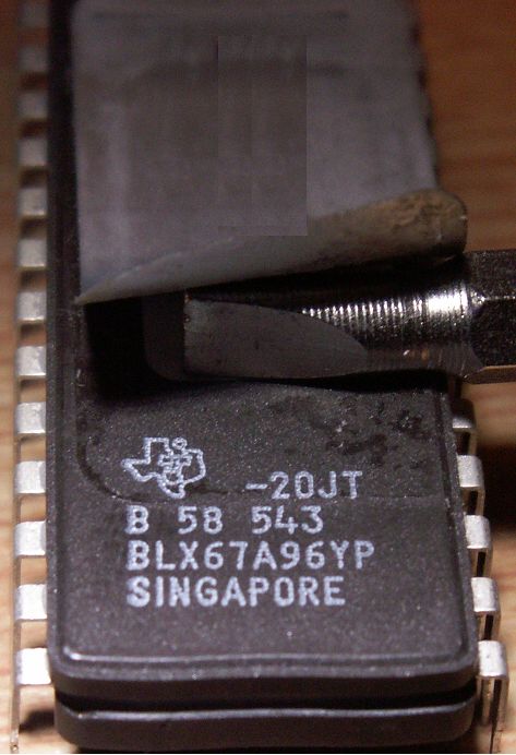

Hi Guys,
Could someone tell me what this type of eprom is ?
52.66 KB
Car Peugeot 406 1,8l 16S - ECU Bosch MP5.1.1
in a forum post I found this
B58543 Eprom unknown 27C512 unknown
On GQ-4x With 27C512 device i can read it but with write error .
Posted - 12/12/2011 :  13:53:21  Show Profile
It may not be 27C512.
Use ID button to check the chip ID. It will report what is this chip.
if it is eprom, it needs to be UV erased, before write.
the image shows an erase window on top of the chip?
Posted - 03/13/2012 :  13:50:00  Show Profile
yes. All erasable EPROM has a glass window on top. Unless the chip is plastic and OTP chip, then is has no Window on top.
