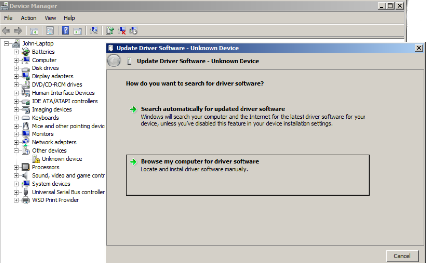

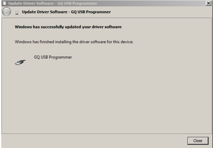

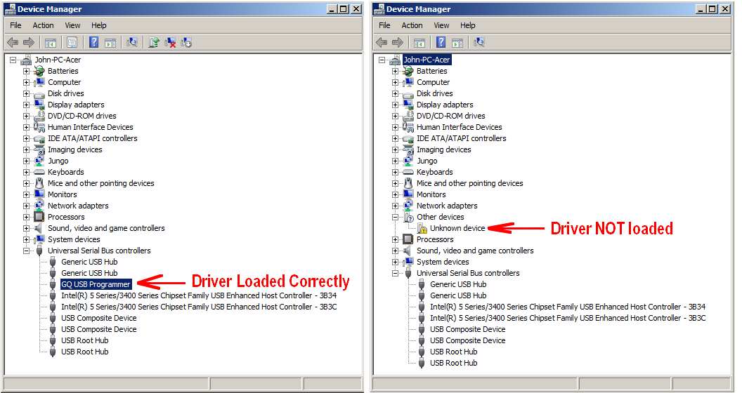

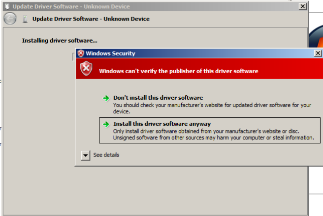

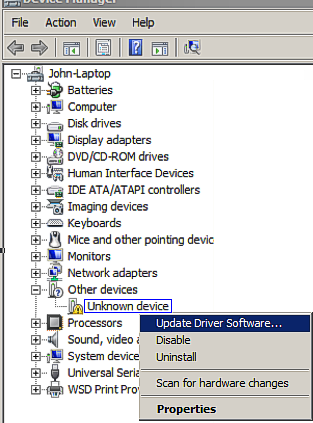

Check the USB driver from Windows Device Manager first. see:
[b]Image Insert:[/b][br]
[br]
For unknown device in the device manager, you need to [b]Download and install the USB driver Re2.01[/b] via Update the driver:
