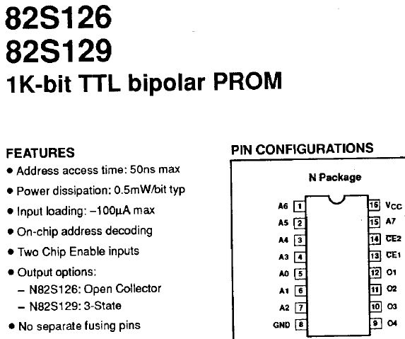

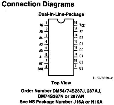

Does anyone know if the Willem EPROM Programmer V50B is capable of reading 82S129/74S287 bi-polar TTL PROM chips? I would think it should, it's just a matter of getting the correct DIP and jumper settings for the chips with pinout as follows:

I don't need to write new PROM chips, only read the contents of some good chips so I can replicate them on a CAT28C16ALI90, which programs quite nicely with my Willem.

I couldn't wait for a response so I figured out a different way to do this. I built myself a reverse adapter.
I got one of these adapter so I could replace the N82S129 chip on my device with a CAT28C16ALI90 EEPROM. (You can also use a 2716/2732 EPROM if you like.) Excellent part, excellent service, well worth the price.
www.brinkleyelectronics.com/prog/mot/syn/sab/sab.htm" target="_blank">h p://www.brinkleyelectronics.com/prog/mot/syn/sab/sab.htm
I figured, if the adapter goes the one way, why not the other way? Would only cost me a little time and materials to try.
So I basically built myself the inverse of this adapter. So it has a DIP 16 socket to plug in the N82S129 and then goes to a DIP 24 socket which I can then plug into the Willem. Select 2732 chip type and voila reads out the contents of an N82S129 like a charm.
